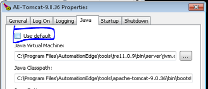

  • Double click on the tomcat9w.exe file from apache-tomcat/bin location
  • Click on the JAVA tab and Check the Use Default option for the Java Virtual Machine option.
  • Now start the tomcat service
