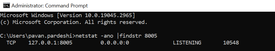

Hi!
Check if port no 8005 is consumed by another service given in the below screenshot.
Open Command Prompt
Run command netstat -ano |findstr 8005

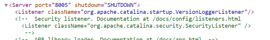

Change the port number in server.xml file under apache-tomcat/conf/ location.
Start tomcat service.
