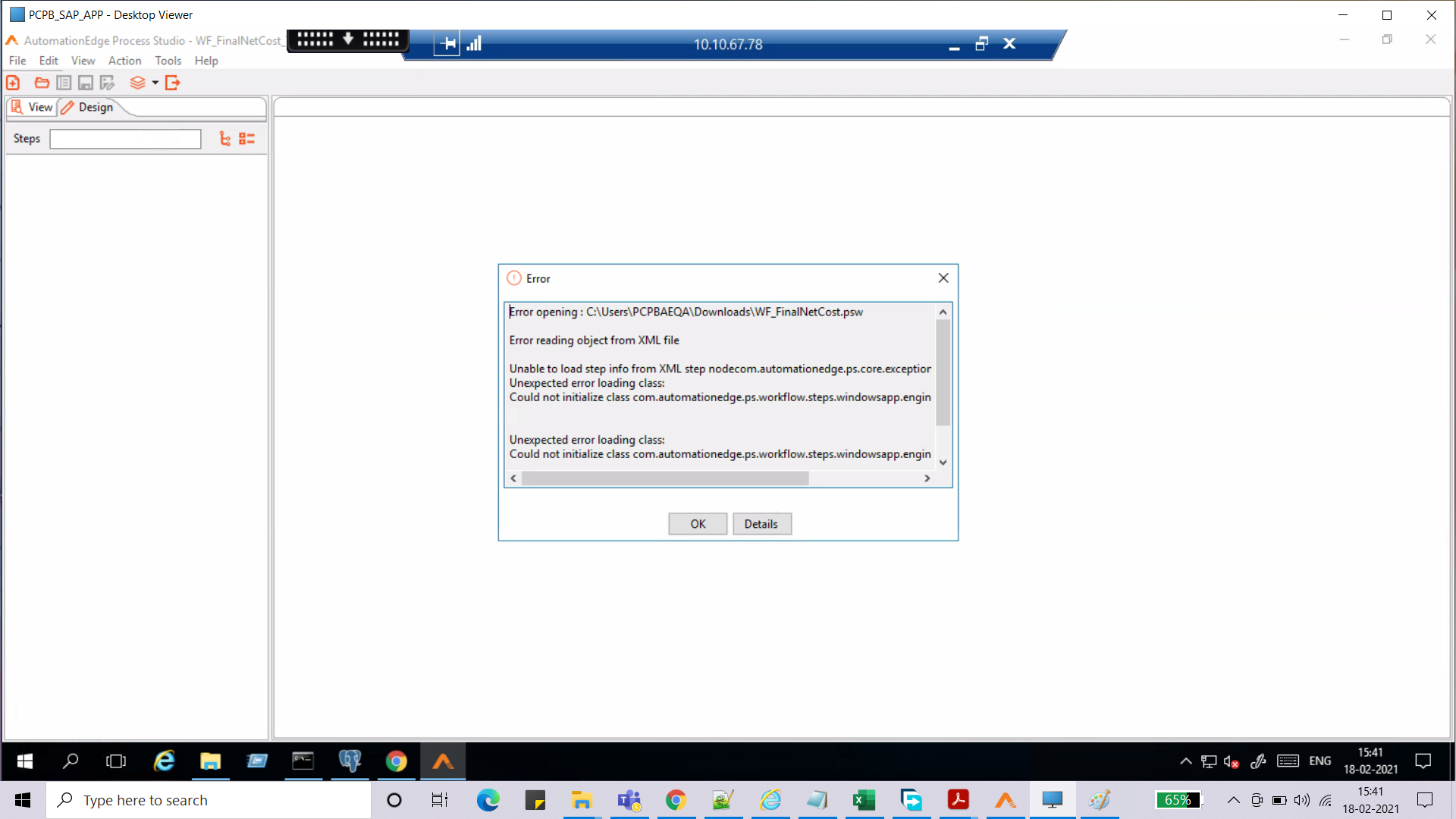

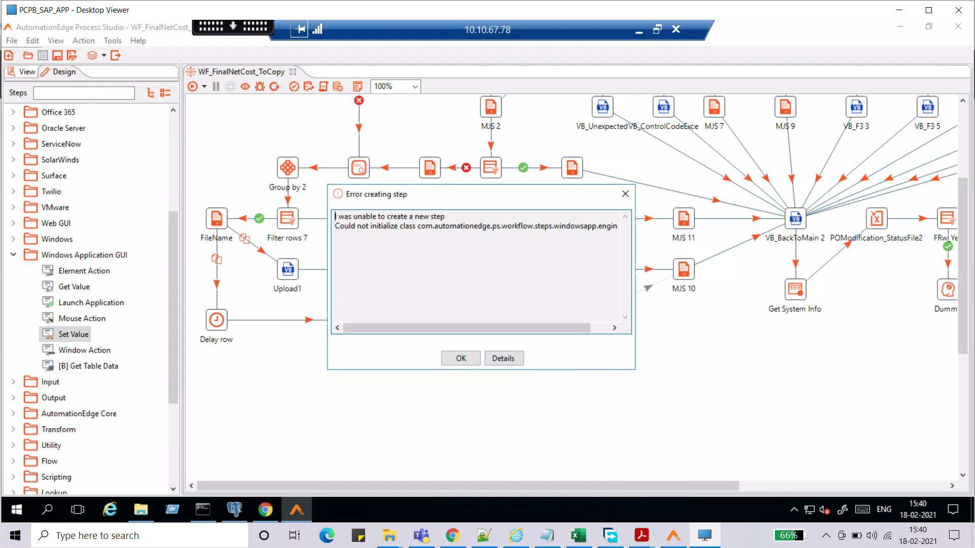

I get the following Windows Plugin error:
2021-02-17 21:02:29 main ERROR ProcessStudioException:81 - Error reading object from XML file
com.automationedge.ps.core.exception.ProcessStudioXMLException:
Unable to load step info from XML step nodecom.automationedge.ps.core.exception.ProcessStudioPluginException:
Unexpected error loading class:
Could not initialize class com.automationedge.ps.workflow.steps.windowsapp.engine.Utils
Please help with the resolution.
Hi! Tom,
This issue occurred due to Java version 15, you will have to use java 8 in order to use the Windows application plugin on AE/PS 5.6.0.
