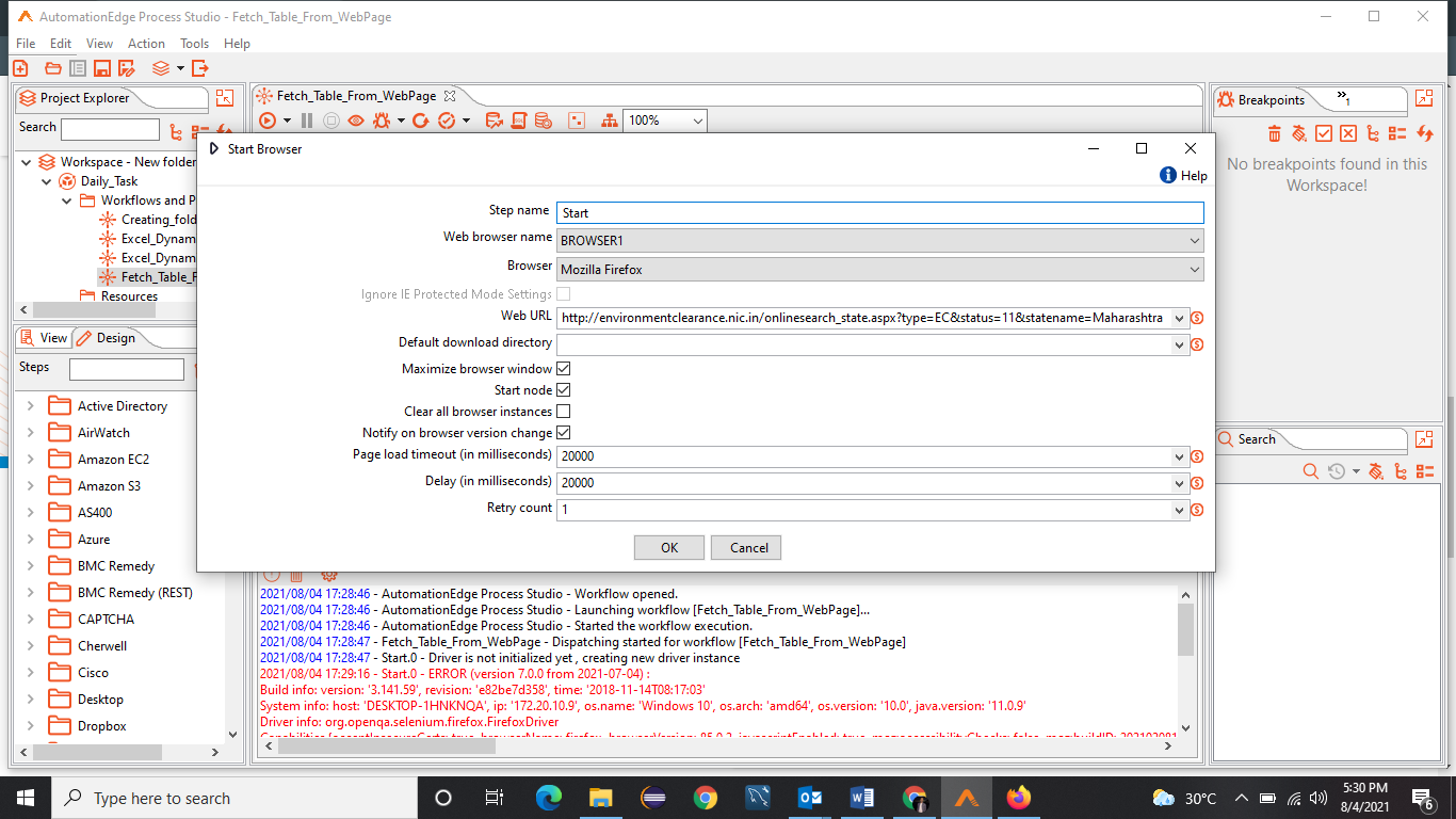

Getting this error while using Web GUI :
Start.0 - ERROR (version 7.0.0 from 2021-07-04) :
Build info: version: ‘3.141.59’, revision: ‘e82be7d358’, time: ‘2018-11-14T08:17:03’
Hi Shekhar,
Please help us with the complete error screenshot.
Hi Shekhar,
Thanks for sharing the screenshot. Can you share the workflow if possible?
Hi Shekhar,
Try by setting the Page load timeout and Delay value to 60000 and check.
