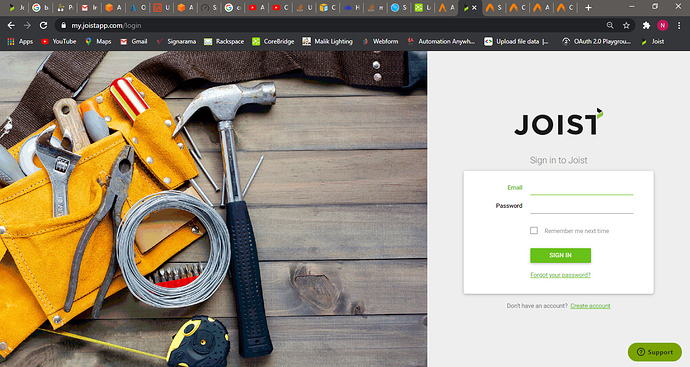

Can you please elaborate this with an example on exactly how to use this.I have a webpage that requires username and password to logon
