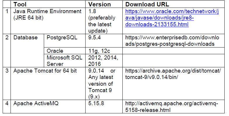

Cause: This error is seen when 2 different versions of Java are installed on the agent machine
Resolution:
Please make sure 64 Bit JAVA version is installed
find the below-attached screenshot for your reference.
