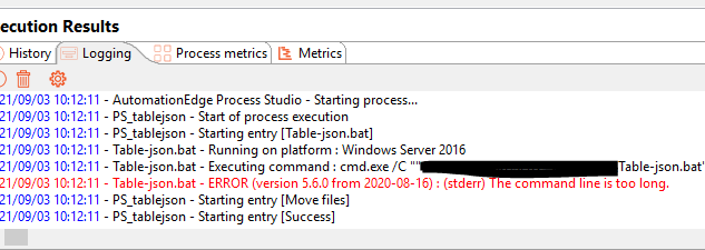

We get the below error when we use Execute a Shell Script Plugin.
This happens when you enter the character or character in a Parameter that is more than the Windows character Limit.
[https://support.automationedge.com/galleryDocuments/edbsnde7cfd99ca9e99b02562b12b877fe55d32fb3795672ef58e278c1c90ffc5494a8d52ebb7f246dd0046efbddf9cc8bf3d52f307557b0d1a613fb617208b67c323?inline=true]
NOTE : The maximum length of the string that you can use at the command prompt / Plugin is 8191 characters. If the Character in the plugin is more than that, the process will fail.
Hi!
To resolve this kind of issue, we suggest to use 2 plugin instead of 1 plugin to execute more that 8198 characters.
