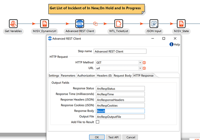

I will showcase an example. Here is a partial snapshot of a workflow to get the list incidents from ServiceNow.
In the Advanced REST Client the response body is captured in the field - Result.
