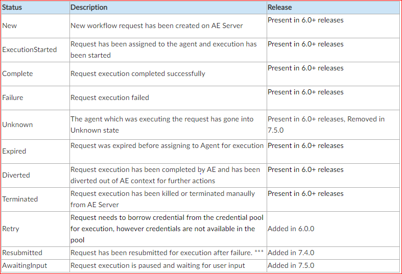

“Retry” status of the request means that workflow request needs to borrow credential from the credential pool for execution, however credentials are not available in the pool, so it keeps on retrying to borrow credential from the pool. Now, here --credentials not available-- can mean any of the following:
As of release 7.5.0, we have the following values for request status:
This status is only applicable/visible to the tenant having CONSUMPTION type of a license. If failed request is restarted for execution, then parent request status is changed to “Resubmitted” and AE Server creates a new request.
As of release 7.5.0, the following are values for request status:
