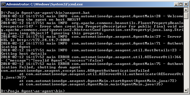

If we are assigning our own agent on another PC then it shows registration failed.
Hi Sagar,
Please find below steps:
-login with your server url on another system where you want to
assigning the agent
-after login download the agent
-unzip the folder
-go to bin path and run the startup.bat
